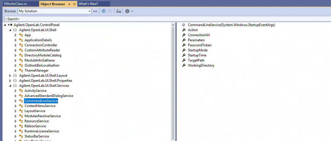

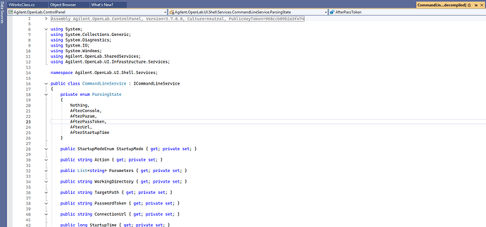

I did something to control the vwork software to run protocol file through LIMS interface of vwork, for at that time I do not have the vwork API manual. I think do as the manual will be the best way. But it will be possible to control vwork, and I share the code.

for handling user name and passwork in login dialog, following code was used (run under administrator)
huser = FindWindowByCaption(IntPtr.Zero, "User Authentication");
var btnHandler = FindWindowEx(huser, IntPtr.Zero, "Button", "OK");
SetTextt(huser, 1000, user);
SetTextt(huser, 1012, password);
