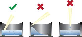

At least with both of these protocols, you can have multiple aspirations happen in a single wash protocol, where you tell it to aspirate at different parts of the well. You can have it aspirate most of the volume at the center of the well (at a safe position above the bottom of the working electrode), and then move to the side of the well to pick up the ring of liquid that is usually still there. You can repeat these side aspirations until there is no liquid remaining in the well. You can try to find the lowest safe z height of counter electrode and Dielectric electrode and safely pipette there. It looks like MSD wants you to pipette here:
