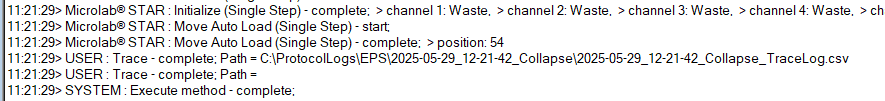

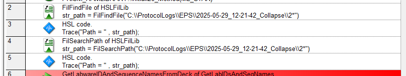

I am using VENUS version 4.5.0.7977. Below is the code that I am using:
The input strings for FilSearchPath and FilFindFile are identical. However, when I run it, the path only comes back for FilFindFile:
This appears to be the case if the two submethods are run independently or if the I reverse the order of the submethods. Can you tell me if I’m missing something?

Hi @spazianim,
You aren’t missing anything. What you’re experiencing is differences in VENUS/HSL versioning. Since you’re on VENUS 4, you’re good to stick with using the FilFindFile function.
