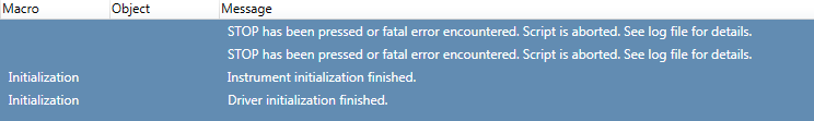

  2. Even when I only upload a distribution worklist with the “Multi-Dispense” box checked for the liquid class, the simulation raises a fatal error and aborts the script. The log file shows one cycle of (get tips-aspirate-dispense-drop tip).
    The distribution GWL file format for distribution is: A; D; D; D; F; W;
    What could possibly cause this error, and why is the tip discarded after the first dispense?
    The error message is attached here:
Any help is greatly appreciated!

for the error you receive, it would be useful to see the actual logfile for the syntax checks

Thank you! I was able to solve the issue with GWL file input.
@sab_s it would be helpful for you to explain how you solved your problem for future reference
Sure! My issue was two-fold:
  1. Worktable needed some changes, making sure there are no collisions, etc., which I gathered from the behavior of the simulation on the log files.
  2. Cleaned up the GLW file, leaving no empty semicolons. Since our software is outdated, I assumed that would’ve added to the issues.
Finally, I cannot say for certain which of these actions cleared the error, but it is worthwhile paying attention to.
