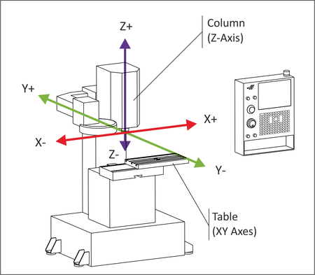

The origin 0,0,0 is the left (x) front (y) bottom (z). If you use a different coordinate space in your robot software, then you’d just need to transpose the coordinates from PLR-space on the backend. This is what happens on the Tecan.
This information is key, thanks! It’s also a good fit for the development docs.
Is this standard practice I can read about somewhere? Are there other conventions like this one that I may come across? (e.g. wells, tubes, or other resources).
This is critical for me because I’m using this information from PLR to decide which coordinates the robot will move to, with almost no intelligence downstream.
The same applies to the origin.
Due to early work with frontend developers, our robot operates with the origin on the left (x) back (y) and bottom (z), as in images or writing. Unfortunately this is not something that will change soon.

I have been talking to @CamilloMoschner about creating a doc page for each (significant) PLR resource type. I will prioritize that. Please keep asking questions in the meantime.
y_plr = y_you,max - y_you right?
Yes exactly. :slight_smile:

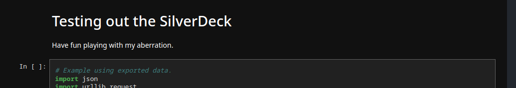

Hi again! I got a rudimentary Deck going.
A deck
Here goes something: pylabrobot/notebooks/deck_development_guide.ipynb at pipetting · naikymen/pylabrobot · GitHub
The only relevant part of the notebook is under this heading (it needs my branch of course):
If you feel like giving it a look, I think the part needing most attention is the tube_racks.py file. I copy pasted lots of code in order to hack a “TubeSpot” class into kind of working. It may be good enough to get ideas going, but it’s certainly not PR material.
This is the best part of my fork IMO:
Fabulous (?)

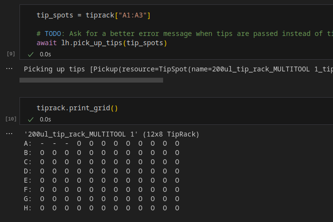

I was surprised to stumble onto a tracking bug in the main dispense function, so wanted to ask about the status on volume and tip tracking in PLR. Is it stable? Do people use it often?
I ask because I am planning to rely heavily on trackers, to validate liquid handling steps before sending them to the backend, and thus avoid having to write my own validators.
