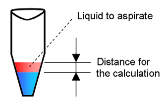

Case 1
The liquid is only in the conical part (segment 2) of the tube. Only the geometry of segment two (the conical shape) will be taken into account for the calculation of the liquid following speed. The speed is calculated from the height of the amount of liquid that will be removed.

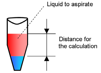

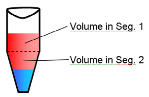

Case 2
The liquid is in both segments of the tube. The calculation of the liquid following speed is a mixture of the amount of liquid in segment one and the amount of liquid in segment 2. An average speed is calculated that suits both segments. The result is a slightly deeper submerge depth in the cylindrical part.
