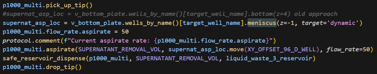

supernat_asp_loc = v_bottom_plate.wells_by_name()[target_well_name].meniscus(z=-1, target=‘dynamic’)
I’m trying to do this while also specifying a low pipette.flow_rate.aspirate to minimize the chances of aspirating away any cells. However, when I run the code on the OT Flex, it appears to perform this step at full speed every time! Has anyone encountered this before?
This is my full code block:
I have flow_rate specified twice in this example, but initially i only had the flow rate specified outside of .aspirate()

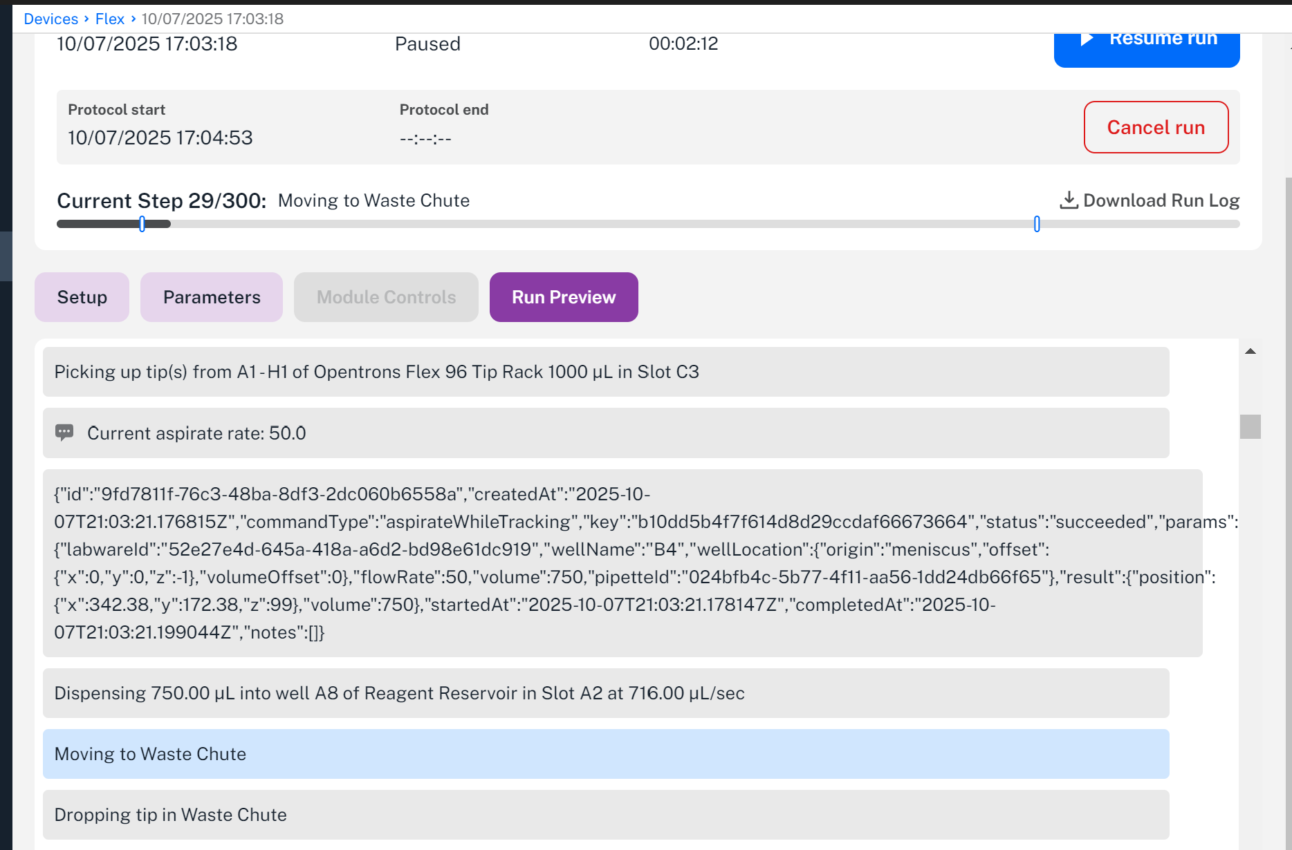

My run log shows that the aspiration rate is correctly set to 50, and the meniscus step seems to be set to 50 as well (but it looks quite strange in the run log)

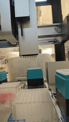

Untitled video - Made with Clipchamp (4)
Here you can see that it’s aspirating rather quickly. With an aspiration volume of 750, this step should take 15 seconds, but it happens in ~1 second!

  • flow_rate (float) – The absolute flow rate in µL/s. If flow_rate is specified, rate must not be set.
I haven’t used this argument before and only used ‘rate’. I suspect that the flow rate was initially defined outside the ‘aspiration()’ commands and then unexpectedly reset to the default, although this reset wasn’t documented in the run logs.
Can they try an aspirate() without the flow_rate argument and see if the robot will aspirate liquids at 50 ul/s?

I initially did this without the flow_rate argument, and only the p1000_multi.flow_rate.aspirate = 50 right before the .aspirate() call!
It resulted in the full speed aspiration and then I tried adding it within .aspirate() in case it helped.
