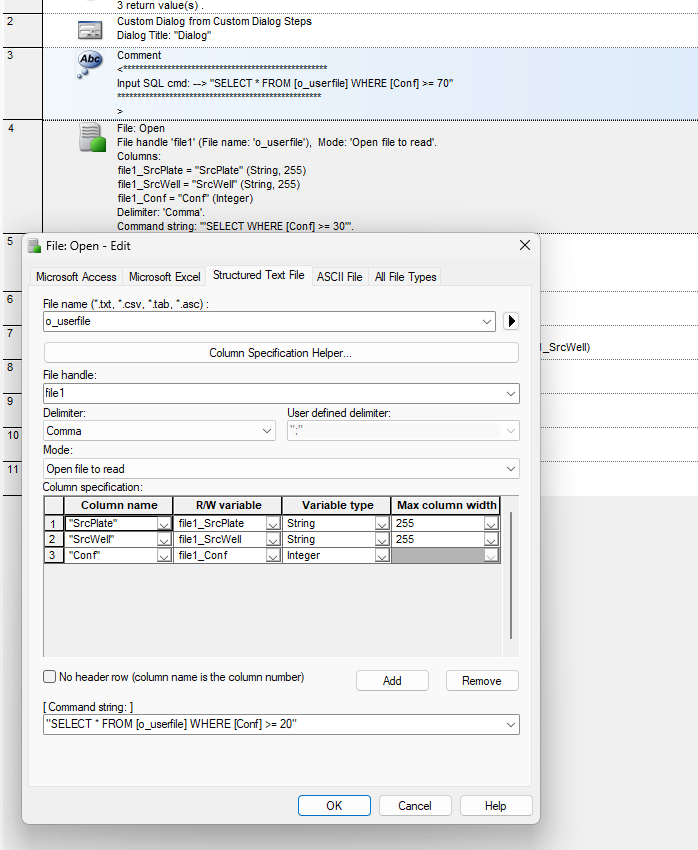

I designed a simple method where a user can browse, upload its CSV that contains 3 columns (Source plate, well, confluency)
I want to put Use a SQL Query to Enhance File Read:
I believe the variable is being treated as a string. I tried a few different synthax but no luck so far.
(I am following this tuto and doing it my way :wink:
https://raverobot.com/how-to-write-a-hitpick-method-in-hamilton-venus/
Is it possible to do it this way (i.e. link the file to a variable and put it in the Command String section)?
Thank you!

Apart from Robin’s example, you should use a variable to create your SQL string. The HslStr library is your friend here for inserting a variable into a string. Also, your 20 is a value and should be in si gle quotes, eg β€˜20’.
Amazing, thank you very much!
Understood, thank you for the advice!
