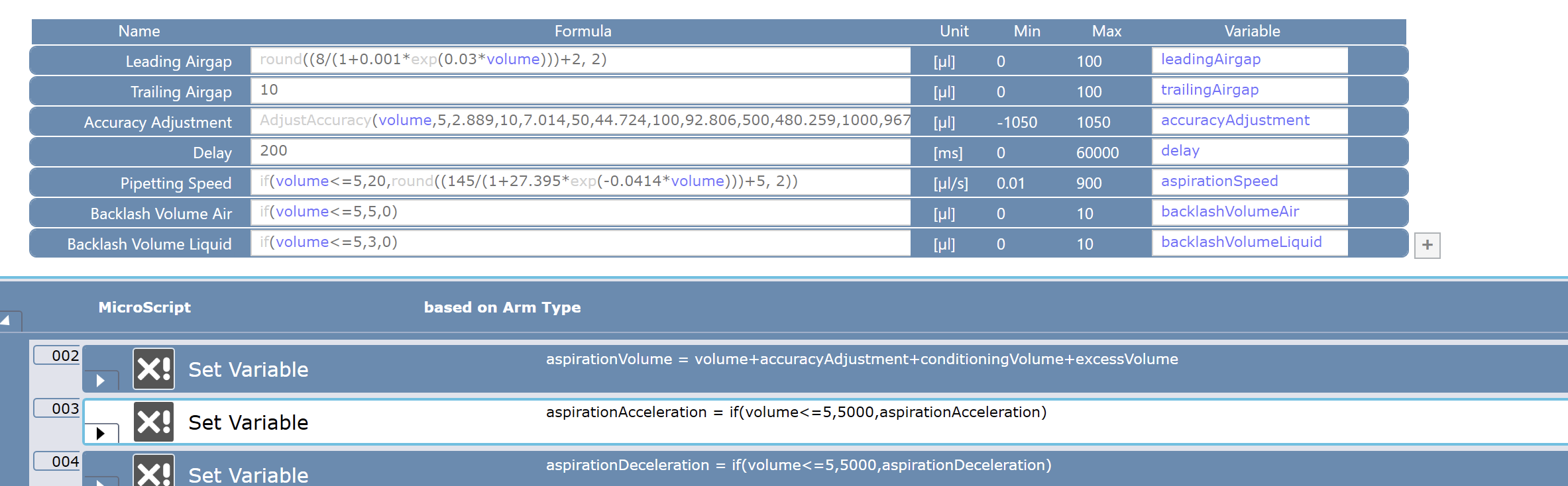

- There are pressure settings you can adjust in the microscript to raise the tolerance (great for any work involving sticky beads)
- Sometimes the default aspirate/dispense speeds are just too damn fast! You can slow these down a bit to minimize pressure errors. You can adjust this in the microscript too.
- You can wrap your pipetting logic in a try - catch block with On Error Go To and then filter the error you want to act on and have the system always auto-select a specific option with On System Prompt. You can then also ask it to report to the error in the log or audit trail so you know what messed up.
I would analyze your microscript of your liquid class since there could be something that you can do at that level without having to change your coding logic

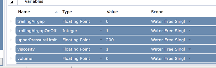

The variables are upperPressureLimit and lowerPressureLimit. You can see what you can control in the Variables tab.
If you change it to 1000, make sure you change the lower limit to -1000.

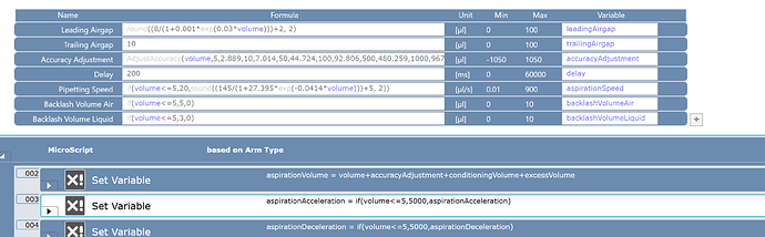

Also you can set them in the formula or at the top of the microscript
Do you know what the units for pressure limits are? It seems to want me to input a unit when adding it into the formula tab
Otherwise I’ll just throw it into the microscript tab

The lowerPressureLimit and upperPressureLimit did the trick. I noticed in their default water_mix command they actually even change it to -1000 and 1000 respectively.
