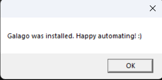

  • Multiple deployment options including Windows installer or just
    • pip install galago-tools

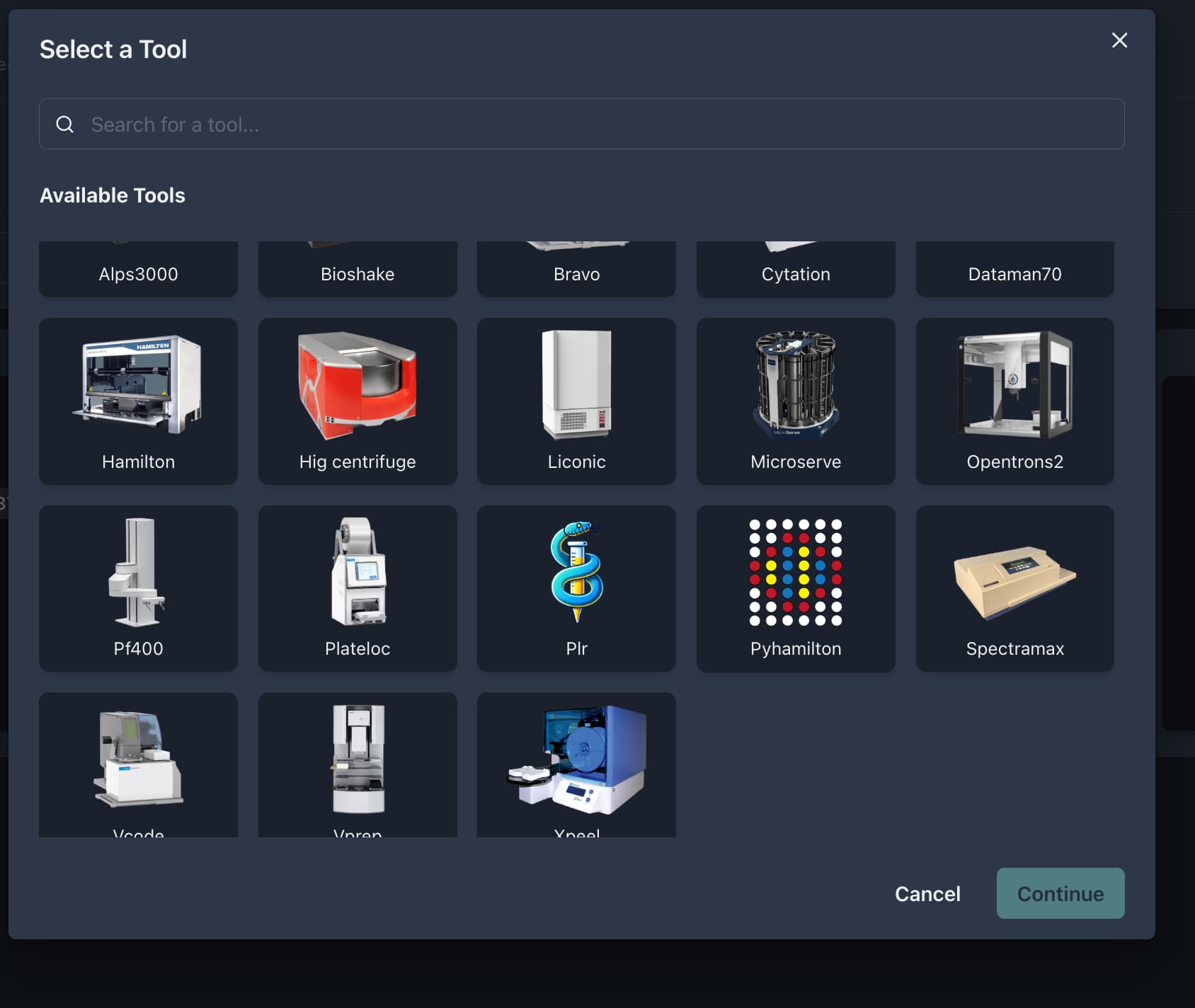

We’ve actually added both PLR and PyHamilton as tools available in Galago. Just updated the documentation with more info on each tool. Here’s a link to PLR and PyHamilton. Let us know what you think!

Any chance you’ll get the thermo fisher arms working on this? This would make it possible to work with our thermo work cells
@cwehrhan not yet. Would you like to help add this to the repo? We currently only support the PF400 when it comes to robot arms. What model arm do you have? You will have to reach out to thermo fisher and see if they are willing to share an SDK with you for their robot arm.
We have this arm: Spinnaker™ 3 Microplate Mover Each | Request for Quote | Thermo Scientific™
I do not think we have the resources currently to aide in development of this :frowning:
Understandable, we’ll keep an eye open for any collaborations that might help with this. Hopefully we can support the Spinnaker soon!
From my experience the PF400 is superior in pretty much every way, so future people reading this go with that even if Thermo pushes their arm
