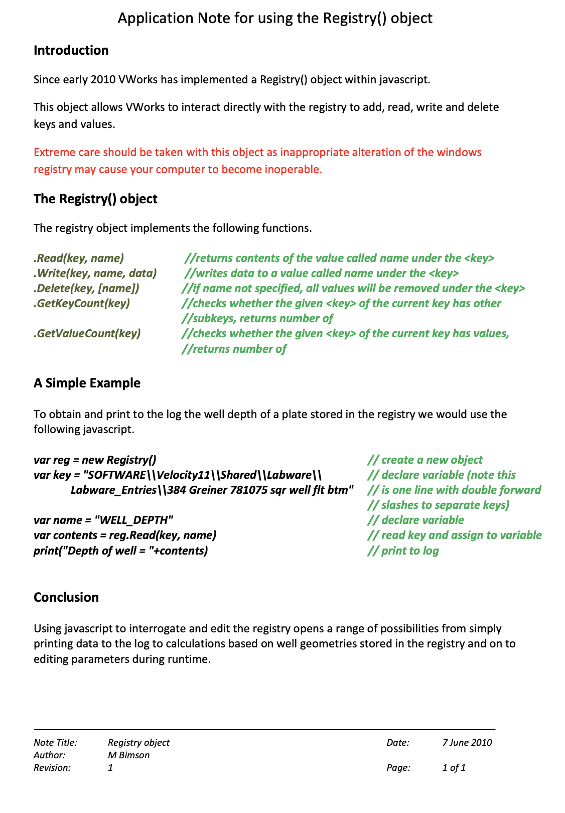

Hey Mauro,
Unless this was removed from the scripting engine, you can read and write directly to and from the Windows Registry with VWorks JavaScript. If I recall, the methods do not show up in IntelliSense:

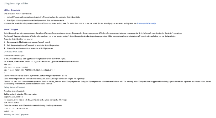

Another question is has anyone tried using ActiveX Wrapper to parse the device information? I found a couple lines of codes in VWorks and thought I could use ActiveX to get stacker information but after I created a ActiveX object with BenchCel’s ProgID its an empty object (I think). Anyone has seen this before?

I’ve used the ActiveX constructor sometimes to connect to some Windows COM objects, for example
var xmlDoc = new ActiveX(“Msxml2.DOMDocument.6.0”);
With this one you can use Xpath to extract values from XML nodes, see the plateInfo function in my GitHub repo VWorksExtLib.
I would not suggest trying to connect to the Benchcel via ActiveX other than when using C# or similar languages based on .NET. There’s no point in doing this if you use VWorks, because it does not add anything to what you can do with VWorks. On top on that our R&D suggests to never install VWorks and ActiveX on the same computer!

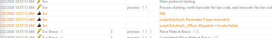

Edit: Actually, if I remember correctly an issue you might encounter is that initialize will fail if you already initialized the instrument via VWorks on protocol start, which is likely the case for you, so this might be a bit of a dead end

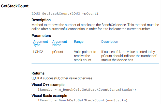

Tysm!!! I used the wrong PorgID lol. Yea I agree its a dead end but at this point I just want to know how this work haha. I am still having trouble getting the number of stacker info and I have the similar error as yours. I think (I might be wrong I am purely guessing) its requiring a pointer as the function input but I don’t know if theres pointer in vworks js.
And I tried using Registry() to parse from a specific profile and it works!! I never know theres registry object haha. Is there a place to look for this kind of information besides the vworks knowledge base?
Yea, that’s a tricky one. I don’t think their javascript engine supports method arguments as refs (or javascript in general) :grimacing: . Did you try just passing a declared var eg. as the argument and the printing its value.
Something like:
var countRef = 0
ocx.GetStackCount(countRef);
print(countRef);
Yea I did… didnt’t work :frowning:
Registry() is the only undocumented constructor. Everything else is in the knowledge base. It was used in our AssayMAP product to set up the teachpoints of a number of profiles based on a parent profile. it is useful, but not essential, as one could replicate it with run() and the CMD shell as I have shown before. The problem is that it stops the js engine if pointed to a not existent registry entry and no try/catch block works.
