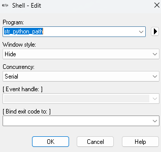

This is the code we use for the A4S.
So basically we have the A4S_Sealer.py we can directly call from the shell like:
python A4S_sealer.py seal -p COM13
Getting this to work in VENUS required some nasty string formatting, I’m sure there are cleaner ways to do this. Bascially we have an HSL block to generate the command, and then just send it via the Shell:
str_python_path = "\"C:\Users\Hamilton\AppData\Local\Programs\Python\Python311\python.exe\"" + " \"" + "C:\Users\Hamilton\Desktop\Metabarcoding on Vantage\source\sub method librarys\\sealer_controler\A4S_Sealer.py" + "\" seal -p COM" + StrIStr(i_int_com_port);
If you need logging you could either make the driver write a logfile with a timestamp or directly route stdout to the log.

As others have said we use command line to pass arguments to the driver. Since we write the driver for a specific customer we tend not to provide the full API, just the commands they use and we make them friendly.
So for example for a plate reader there might be 2 command line params:
Reader.py -o
Connects to the plate reader, issues the open command, maybe wait until the tray is open.
Reader.py -r
Connects again, closes the tray, initiates the read, wait until the read is finished, opens the tray again, returns 0 if all OK, 1 if error. (sys.exit(code))
This return value can be read in virtually any robot system that can issue a command line executable.
Even parsing the reader results and returning them in a CSV is very easy in Python.

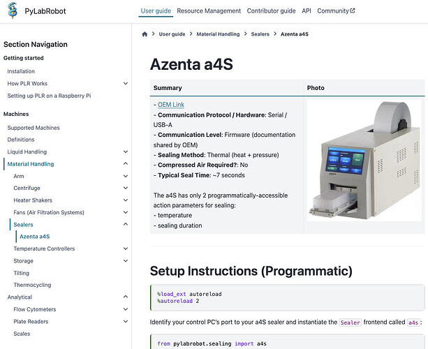

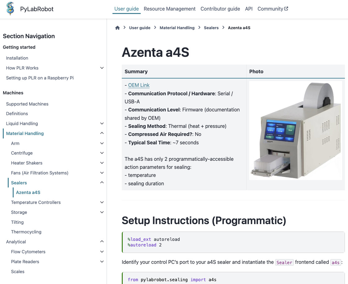

we have a bunch in pylabrobot:

@rickwierenga Funny enough, I have already started diving into PLR as we speak, which I also made an account on the PLR discussion forum :slightly_smiling_face:
Also, thank you @CamilloMoschner for the in-depth explanation!! I have heard of SiLA but couldn’t wrap my head around it until now, so thank you for the heads up on its limitations. As for my integration, I wouldn’t say that I am forced to use VENUS; rather, I am more familiar with it than I am with any backend coding (Python, including). Hence, my purpose is to integrate it into VENUS by executing a Python script, as you and others have mentioned in this form.
Also, another question that came up in that regard, in order to use PLR, I would need the respective drivers of the instrument for the backend coding of PLR to communicate with the frontend device GUI, correct? For example, for the VSpin centrifuge, I would also need VWorks in order to use PLR. I’m asking simply because I am working on integrating QInstrument BioShake via pySerial. I noticed that I do not need to have Q-COM installed beforehand, but then again, it seems like the BioShake falls into the OEM provides a high-quality API as you described.
