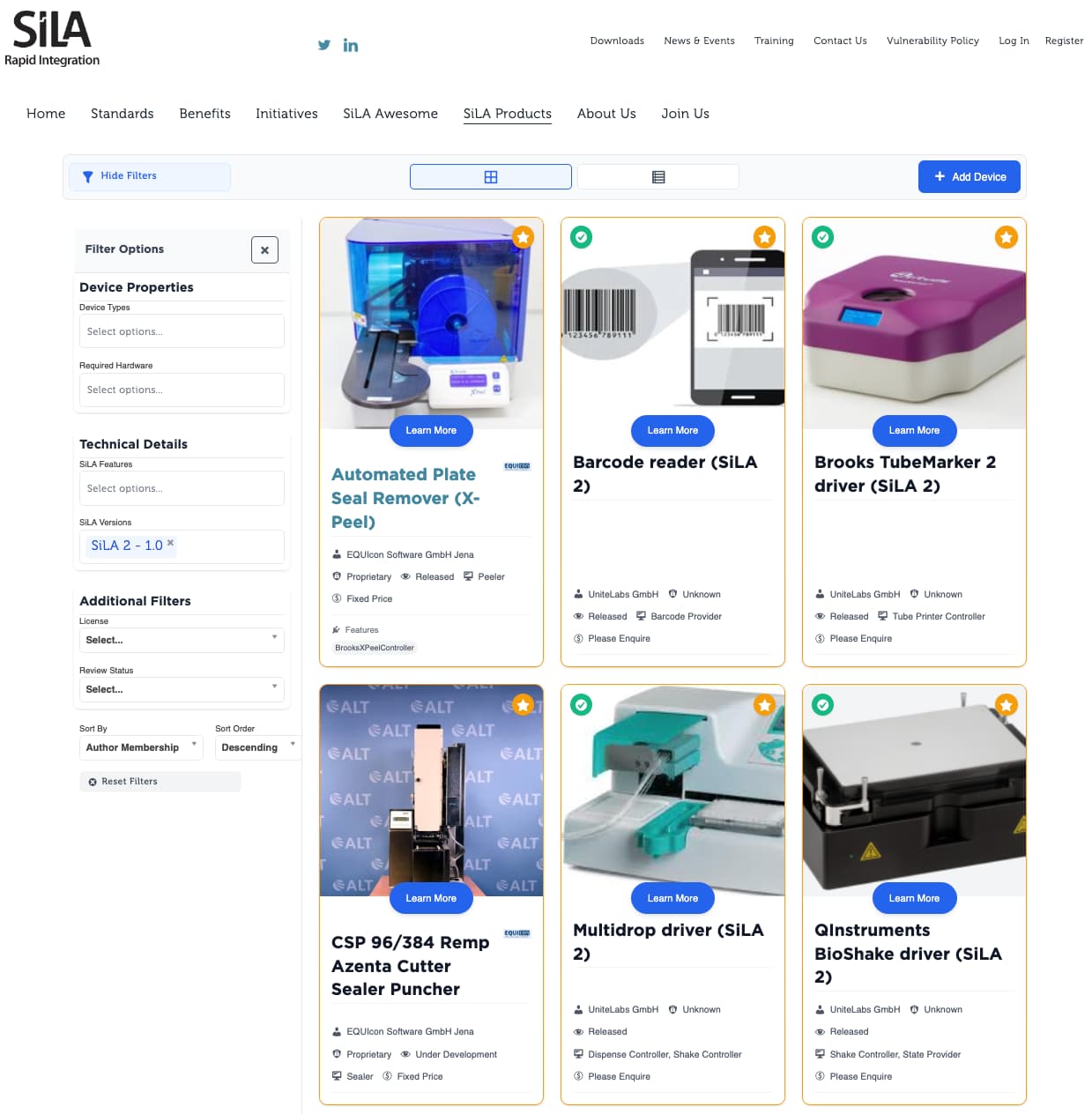

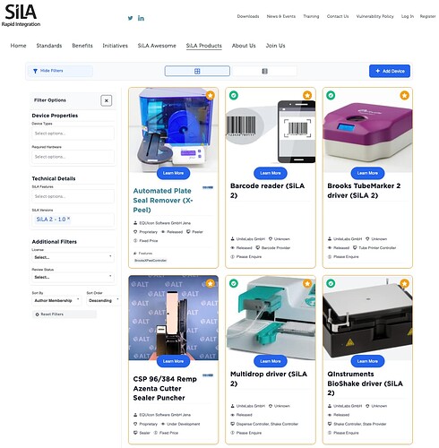

I was talking about the SiLA-standard website: https://sila-standard.com/sila-membership-application/.
To my limited understanding, this is the official SiLA page and one can easily filter for SiLA2-integrated machines in their “products” page:
Which in this case is quite opaque about how much one of these SiLA(2) “connectors” or drivers costs, asking to “Please Enquire” when it comes to pricing (not explaining whether we are talking about licensing or one-off fees), and says “Unknown” or “Proprietary” when it comes to their licensing … obviously, that is the opposite of open-source :slight_smile:
