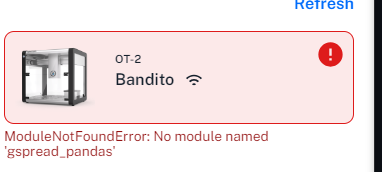

When running protocols via the app, the v8.3 opentrons does not seem to recognize any non-native python packages, even though we already installed them on the opentrons via SSH. (Please note: I am not talking about the pre-simulate on the computer connected (picture below of what I am not talking about)) This has always been a small issue that our users have just ignored, even on 6.2.1
When we try to run this protocol via the app, it gives the error “gspread-pandas not found” or whatever library we’re trying to use.
