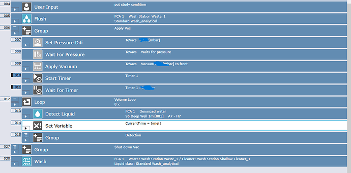

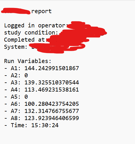

we noticed today that even without aspirate and dispense commands, it is not using all 8 tips throughout the detection process (we do have a loop to measure liquid level of a 96 deep well plate). It only reports values when the tips went down during detection command and the selected tips for detection are random. see the results file, tip 2 and 5 stayed up and gave volume as 0.

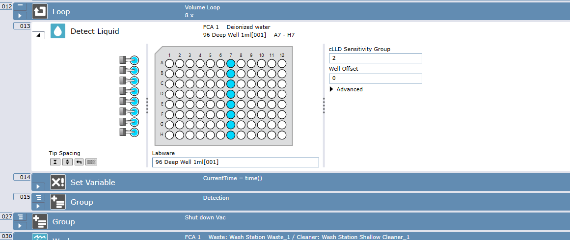

if you open the “advanced” section - curious to see if there’s a mask on the tips to use
the tip selection is blank. we used the same deepwell plate and placed another location other than on top of our tevac system and it works fine. looks like there is something special about that tevac location.
