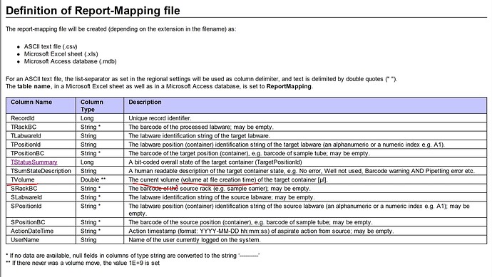

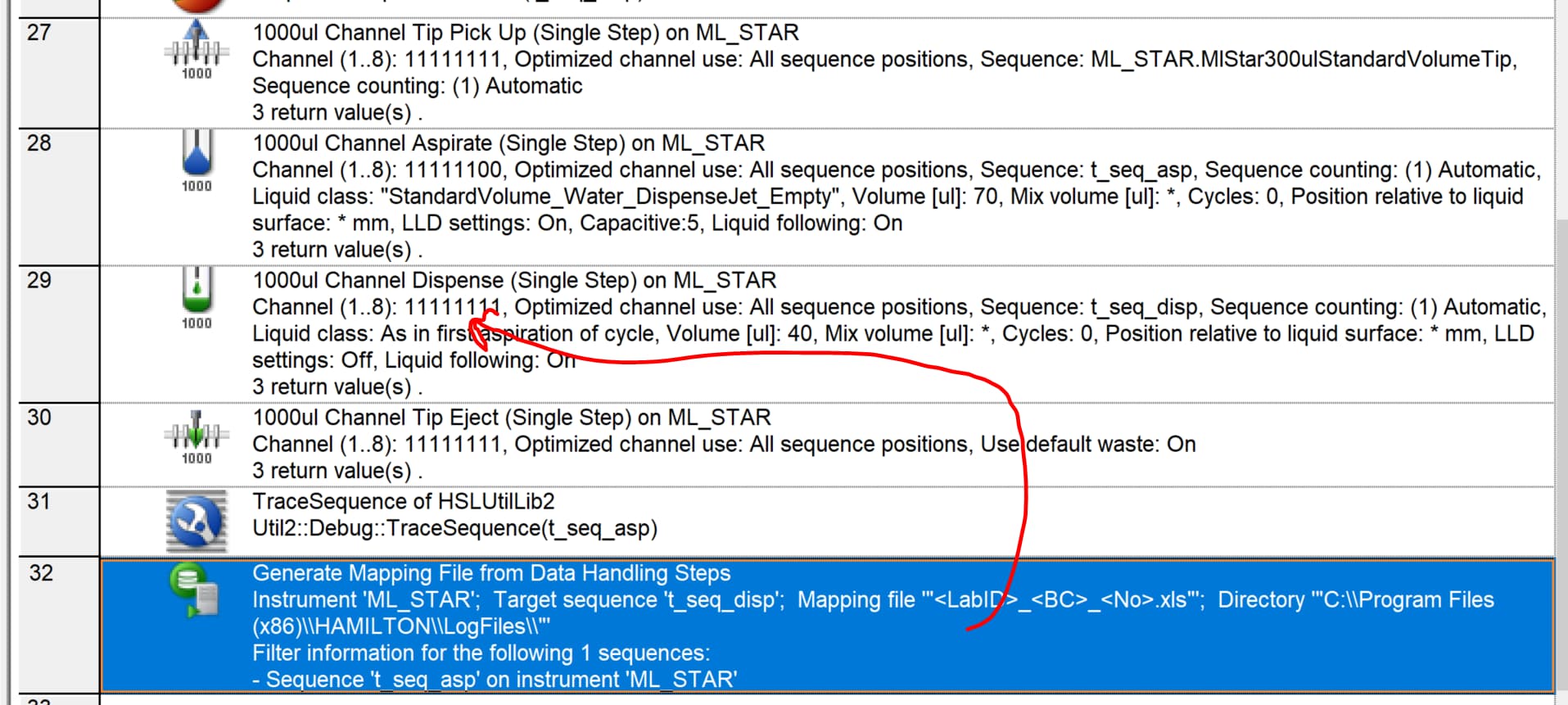

I have been playing with the Generate Mapping File smart step and ran into a limitation, where the volume transferred (Tvolume) is the total well volume at creation time of the File, not that individual pipette steps transfer volume:
This becomes an issue when you have one dispense step that transfers to the same well all in the same dispense step. Since it is showing the CURRENT VOLUME of the target container at creation of the file the mapping function will distinguish each transfer as unique, but show the final volume of the well! I really want a record of every transfer automatically generated!
This makes it a bit hard to interpret into a LIMS as each row is broken down into a unique transfer but the total volume is not the actual volume transferred for that row.

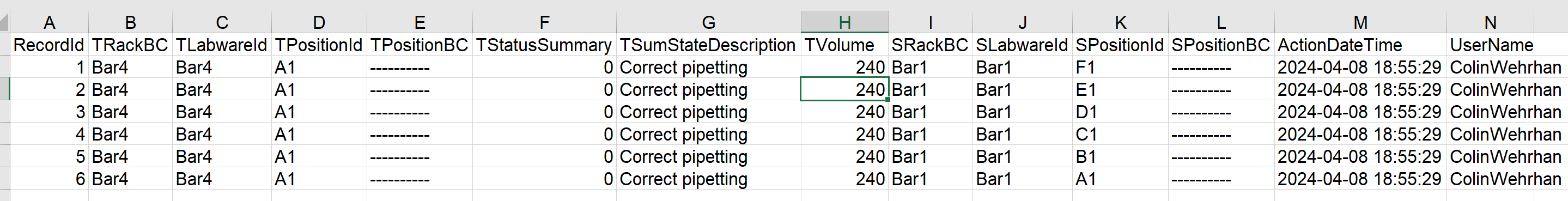

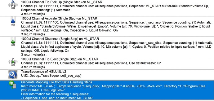

An example, I transferred 40ul 6 times all into the same well:
When looking at the mapping file it appears that 240ul was transferred each unique row, but alas this is current volume of the container.
When interpreting this into a LIMS it works great when you don’t hit the same output well twice! The minute you do you’ll have to do some reverse lookup to see if that well has already been hit.

Removing the labware virtually is not possible since all my dispenses occur at the same time into the same well, all in one dispense step.

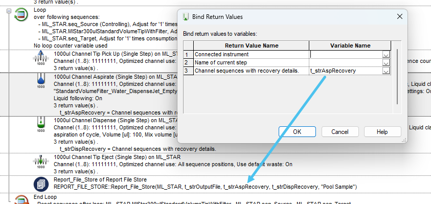

You can use the following library to create a Mapping Report using the step return values from the Aspirate and Dispense Steps.

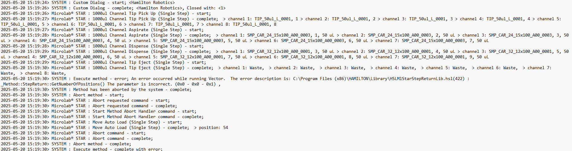

….HSLMlStarStepReturnLib.hsl (422): _Method::StepReturn::GetNumberOfPositions() The parameter is incorrect. (0x0 - 0x0 - 0x1)

Can you send a snapshot with your implementation? Tracing out the aspirate and dispense return values also would help.
Just to confirm, are you binding your return to the third option on the aspirate and dispense?

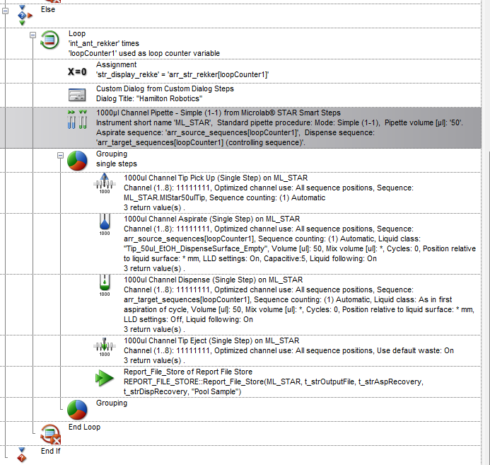

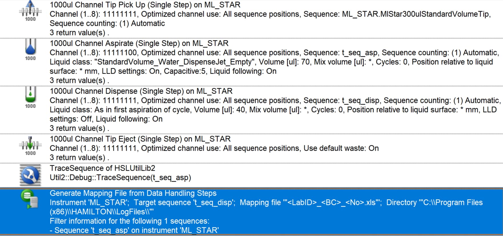

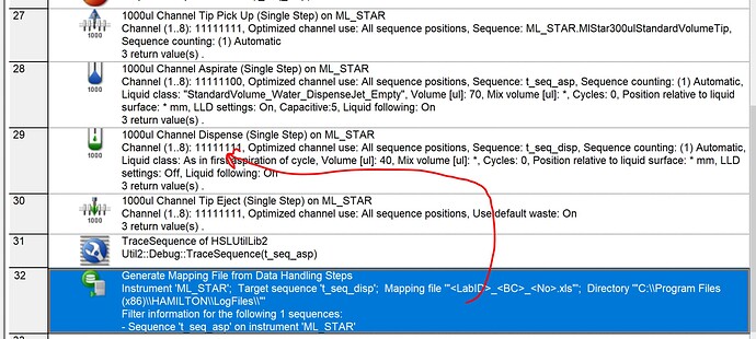

Here is the part of the method (I have checked that this step is executed)
Here is the trace (ignore that channel 8 piks up a tip, I just switches over to single steps to use the report file store library, will fix that later):
How can I trace out the aspirate and dispence values?
I don’t know what I’m binding the return value to - I have not selected anything special.
I will look over the method again and see if there has been some variable-binding which I was not aware of.

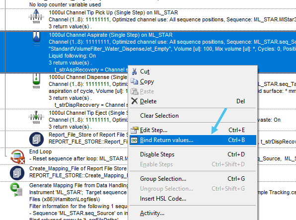

EDIT: I cannot see any variable binding when using single steps (asp&disp), neither in the example method, nor in mine.
OMG - I just found the “Bind return values to” button by rightclicking on the asp. and disp. single step.
The method works !!! :slight_smile:

If you right click on the single step, you will see a Bind Return values… option.
From there, you can bind a variable to one of three return options. The third one contains the step return values that you need for the library to be able to parse the information.
