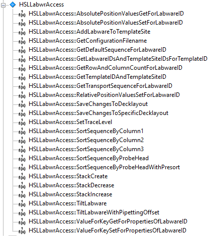

This can be done with the labware access hsl library:
Various features of the deck layout can be altered and saved as long as the deck layout remains closed in any and all instances of the method editor in the background. The deck layout is saved with either of the “save changes” command seen in the image above.

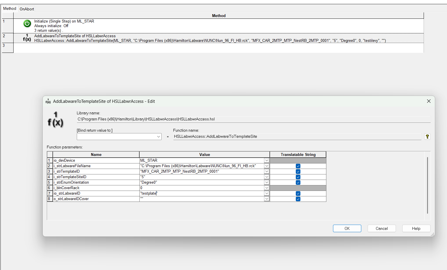

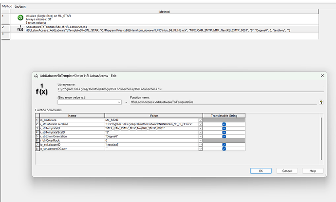

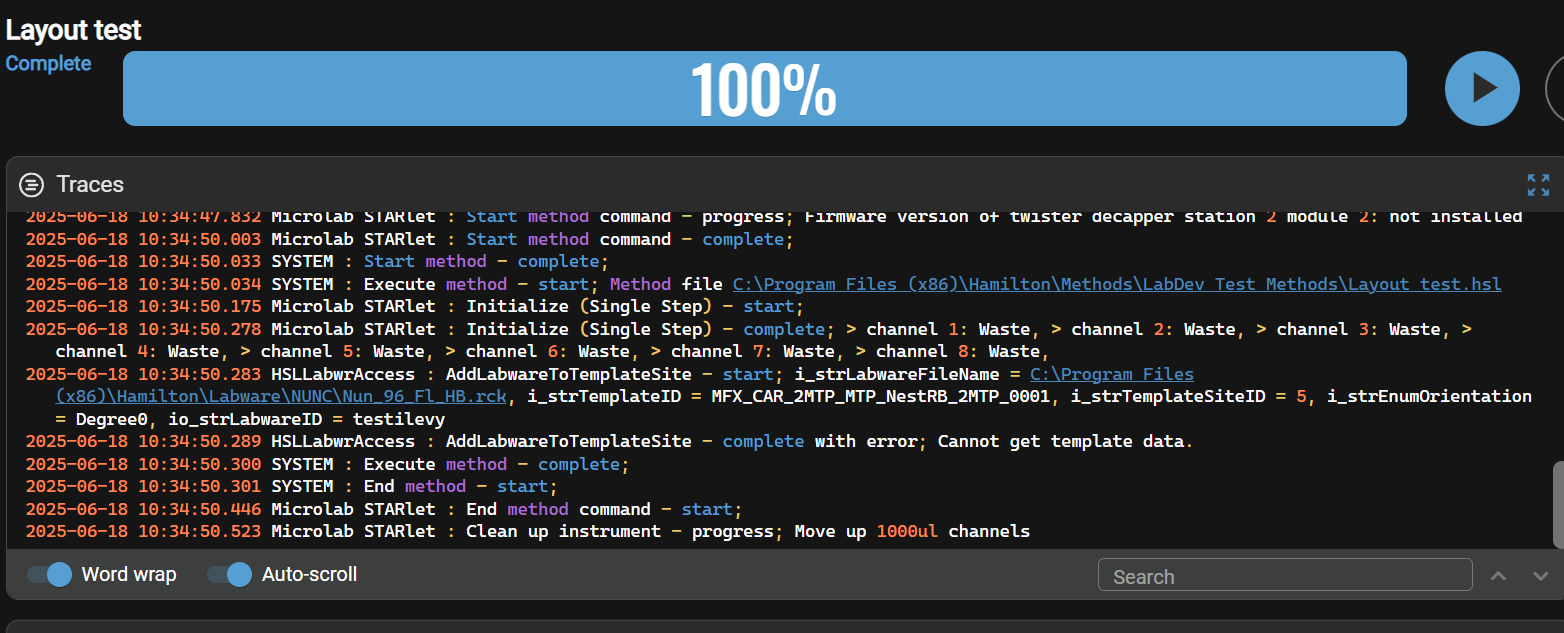

Getting back to this. I have problems with the “AddLabwareToTemplateSite”-function. I get a “cannot get template data” both on my own test method and the library’s demo method, it’s like Venus can’t access the template file or something?
I guess your path is missing the double slashes.
Hi @NFred,
There was an update to the LabwrAccess library for use in VENUS 6 and later specifically for this function (AddLabwareToTemplateSite). The updated library installer can be found here: HSLLabwrAccess v3.0.zip :: Hamilton.
