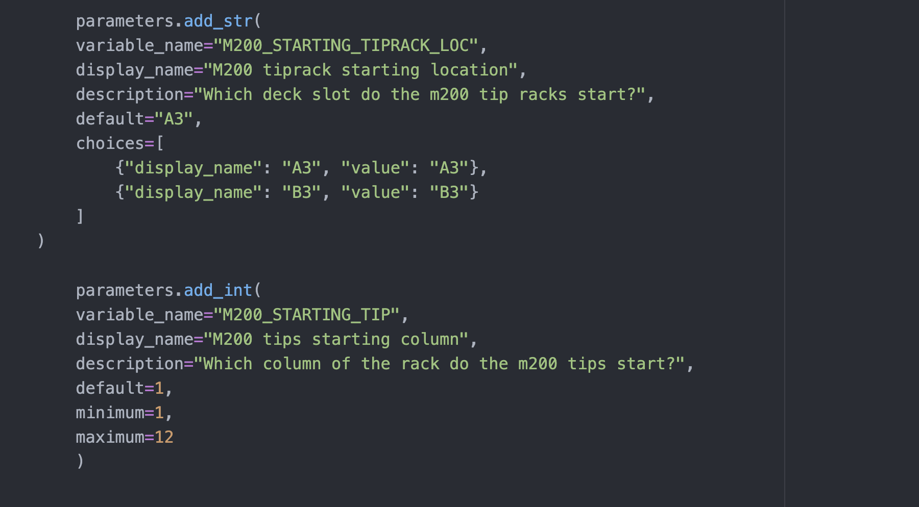

I know opentrons already responded to you but I like this just to be available for others who might want to see it
Here is a real world example:
