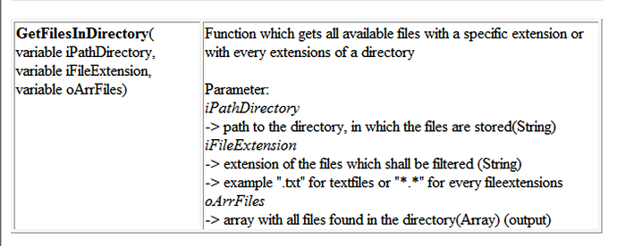

@gwp tried using the FileDirectoryLibrary to loop over a large set of example worklist but the library function GetFilesInDirectory didn’t work. I kept getting an invalid class string error even though I followed the docs on the input types.
You’ll need to run the installer which I uploaded here. But that is what I was alluding to - so long as you put the file in a designated location you can either give it the same name (overwriting as needed) or use commands such as the GetFilesInDirectory from the HSLFileDirectory library to get the file name, then you don’t need a user prompt in your method.
