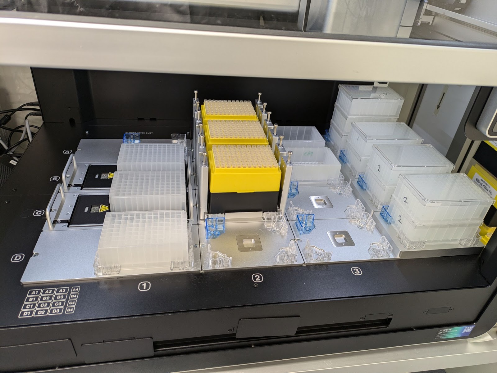

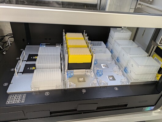

This is just a positive review of the Flex. I got one early this year and at this point my team is running things regularly on it for compound library screenings (cell seeding to media prep to media exchange). We’ve managed to triple out throughput (we were previously using 2x OT2s with p300 / p20 multichannel pipettes) and we’re pretty happy with the system now.
I just personally like seeing videos / gifs of systems that are in use, and I figured there are other nerds here that would appreciate the same
Cell Seeding:
Plate Movement gif
Media Prep:
Media Exchange:

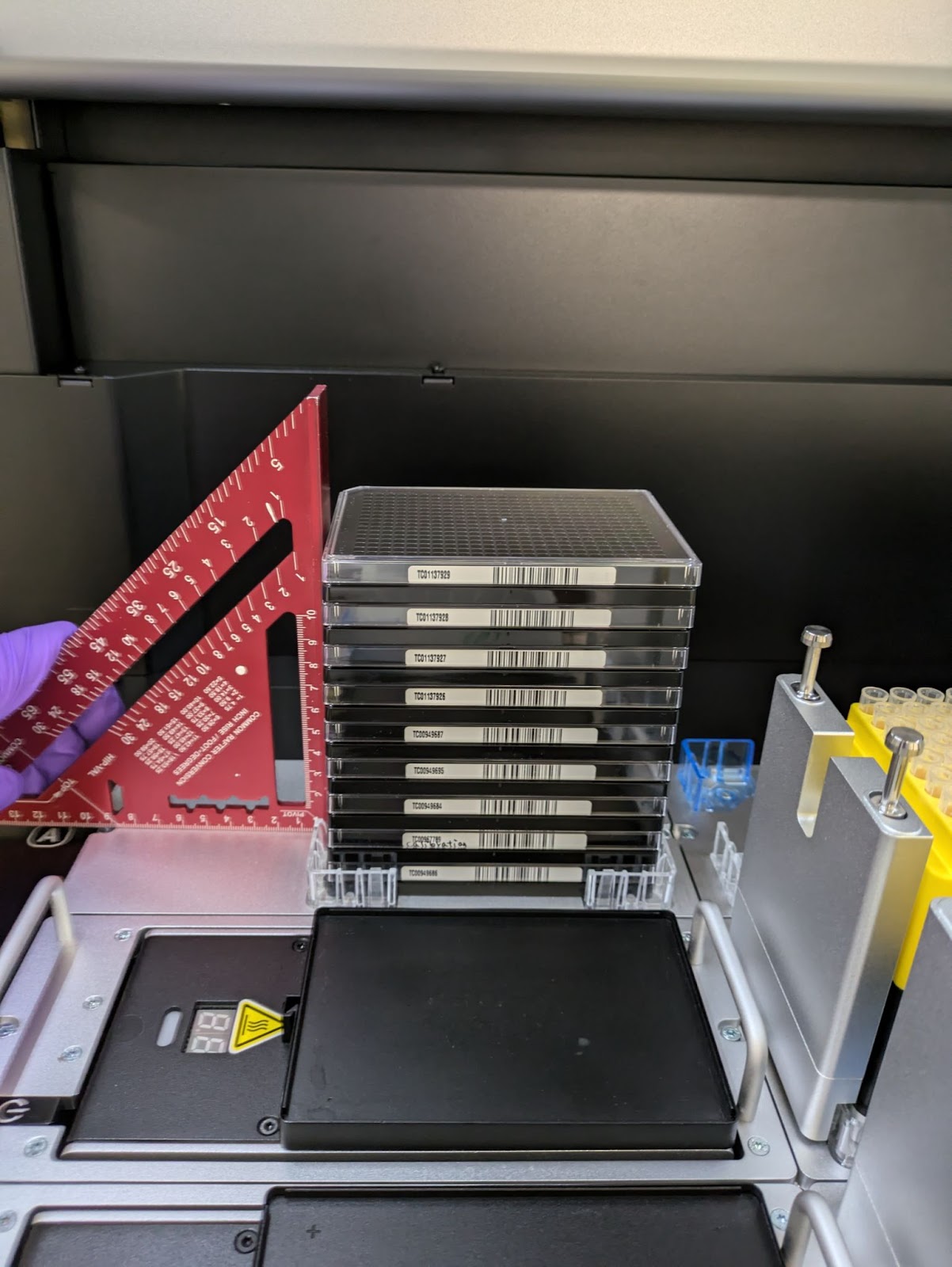

(My stupid solution to ensuring the monster 9 stack 384 MP tower is aligned so that plates actually hit the bevel when they’re moved to a pipetting spot)

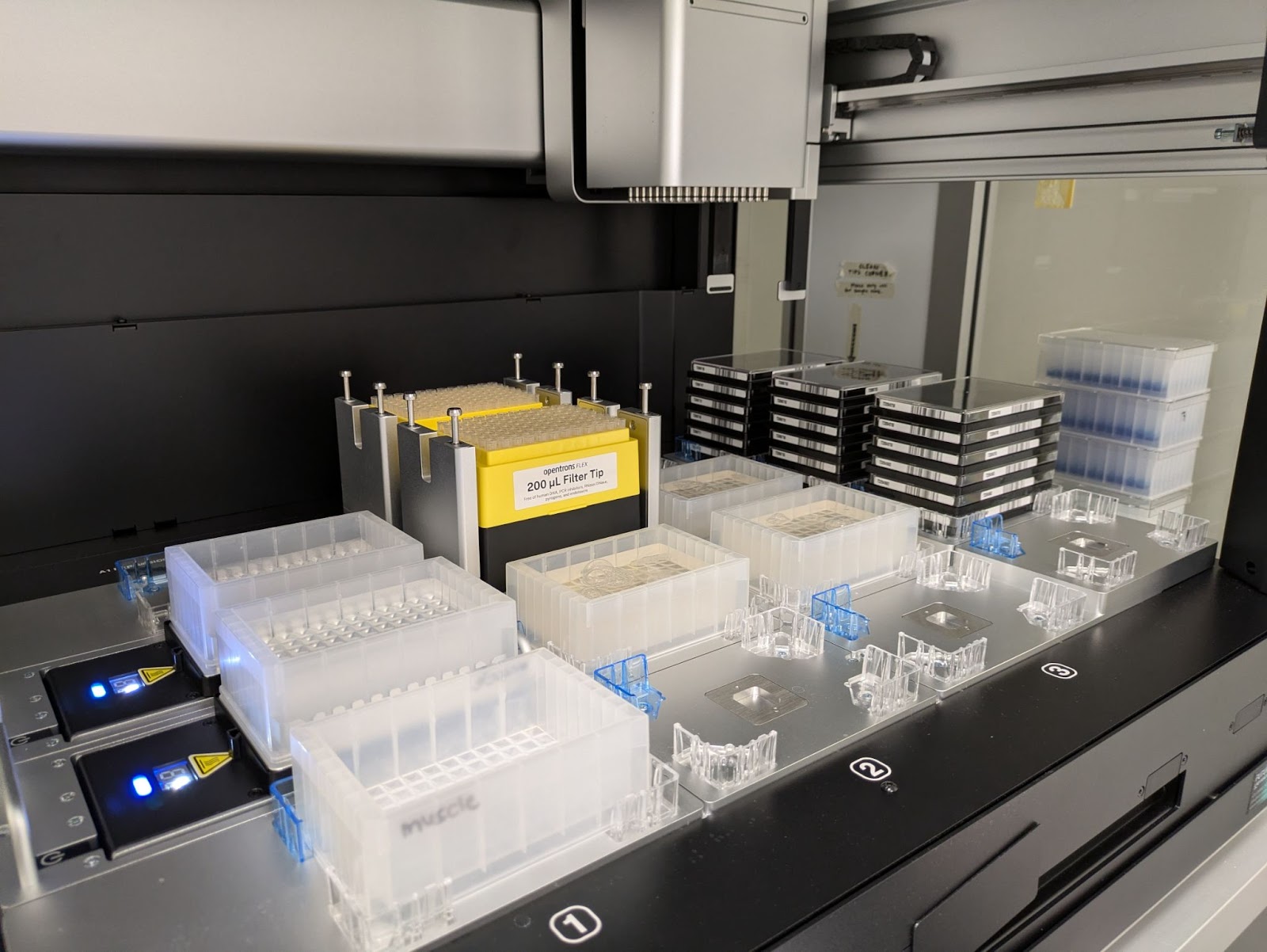

Combined well plates and deep well plates gif

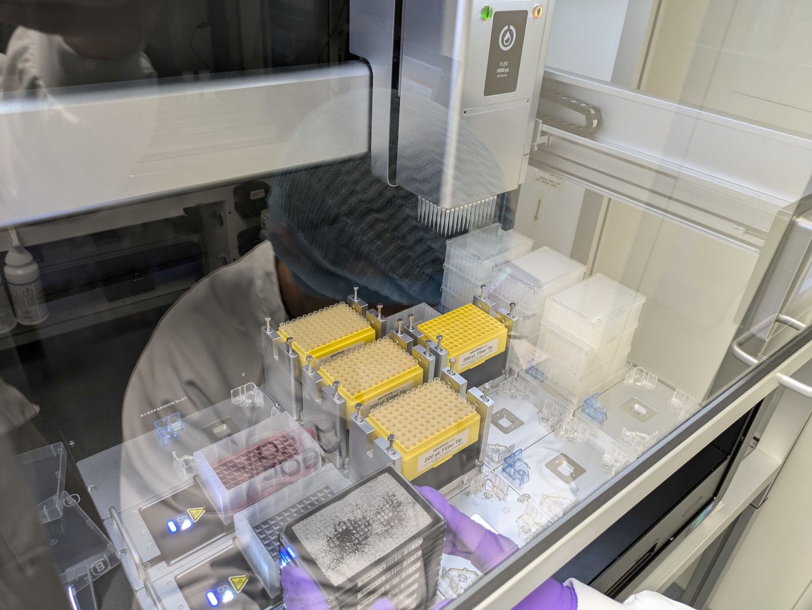

As for the enclosure, we just use a laminar flow spetec hood, which believe it or not is sterile when running. We never get contamination from these guys and they’re also cheap to boot (5-10kish euro). We modified one we previously had an OT2 in to fit the flex since the big bastard didn’t quite fit
