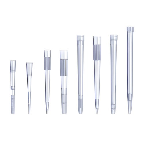

Does anyone know what commercially available multi-channel tips the OT-2 tips. What i want to do is use a manual pipet to help re-rack the tips from partial racks together. I know how similar devices for Hamilton tips but I haven’t been able to find something that will work for the OT. Any advice would be awesome!

We use 8-channel Gilson Pipettemans (pipettemen?) and an Eppendorf one, both p300. They pick up and drop OT p300 / p200 filter tips just fine for consolidation of pipette boxes

I discussed this with our science team, who mostly use Gilson pipettes in their day-to-day. They prefer Eppendorf pipettes and have found they fit our tips very well. If you are mainly looking for a pipette to re-rack tips with, Dragon Labs would be the cheap option, which was also the pipettes used on the OT-One.
The ID of the 20 uL tips is 3.27 mm. You can find some of the dimensions of our tips in our labware library..
