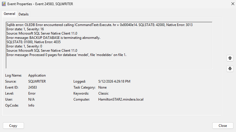

HI Dan,
thanks for the information. Makes sense. I was looking through the logs at saw an error arround the time stating an error in making a DB backup.
apart from restarting the system is there something that can be done to prevent this? is this a scheduled task that can be performed at a set time?

Hi @DrDode,
This task is part of normal VENUS Sample Tracking processing, so it cannot be prevented without disabling Sample Tracking and the Vector Database. Your best options are those I listed regarding storage space, and checking with your IT department regarding any antivirus or similar software that may have be actively interacting with SQL or the Hamilton folder/subfolders at the time the error occurred.
