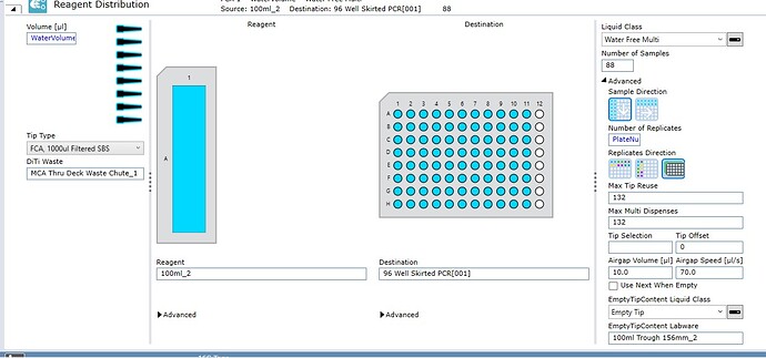

I have created a script that will aspirate water from a 100uL trough and dispense 45uL into 88 wells of a 96-well PCR plate using the reagent distribution smart command and 1000uL filtered SBS tips. I chose to use the smart command because the amount of plates may vary each time (1 to 12 plates, selected by the user at the start of the script). After distributing water to all of the wells, the script then uses Sample Transfer smart command to aspirate and dispense liquid from multiple 96-deep well plates into the 96-well PCR plates.
My only complaint is that when doing the water dispense, even though I have the max tip reuse and the max multi dispenses set to 132, the smart command will dispense each column of the plate into all of the plates (plate number defined by a variable that is set by the user at the start of the script) and then get a new set of tips. I would like it to use the same 8 tips for all of the water dispenses without getting new tips, which you would think would be achieved by specifying the max tip reuse and max multi dispense.
Does anyone have any suggestions on achieving this without using a gwl to create the worklist and modifying the W’s in the gwl file to prevent the tip ejection? I would like to avoid the GWL method since the number of plates can vary for each run and would like to make executing the script as simple as possible for the end user. Is there something I can add to the liquid class microscript for the water to prevent the tip ejection? Attached is a screen shot of the reagent distribution command.
