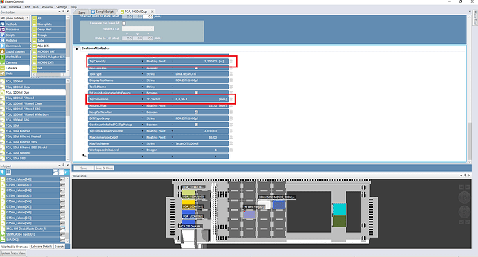

You can always duplicate existing tip definitions to get your starting point, just make sure to modify “TipCapacity” and “TipDimension” in Custom Attributes.
And now that I’m looking at it, there’s a “Mount Offset” attribute. Maybe someone else can confirm if that affects pickup, but it sounds like it might.

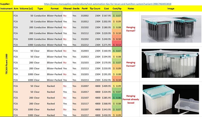

Okay, I’ve found what NEST tips are. Manufacturered by “NEST-Biotech.com”. Some information I compiled below:
Thank you! Tried creating a custom labware and applying your suggestion of the Z-Max. Varied success at this point. The Mount Offset doesn’t seem to have a large effect or influence.

I would compare the teachings of a standard rack and modify that for a custom tip as much as possible.
Compare how high z-travel, z-start, z-dispense, and z-max are from the rack and keep the same proportional information for the new tips. Definitely change the tip lengths or you may collide all over the deck on accident if Path Finder has that info wrong.
Feedback: Managed to get the tips mounted by adjusting Z-Max. Also the Mount Offset lowered to accommodate for the mounting depth.
