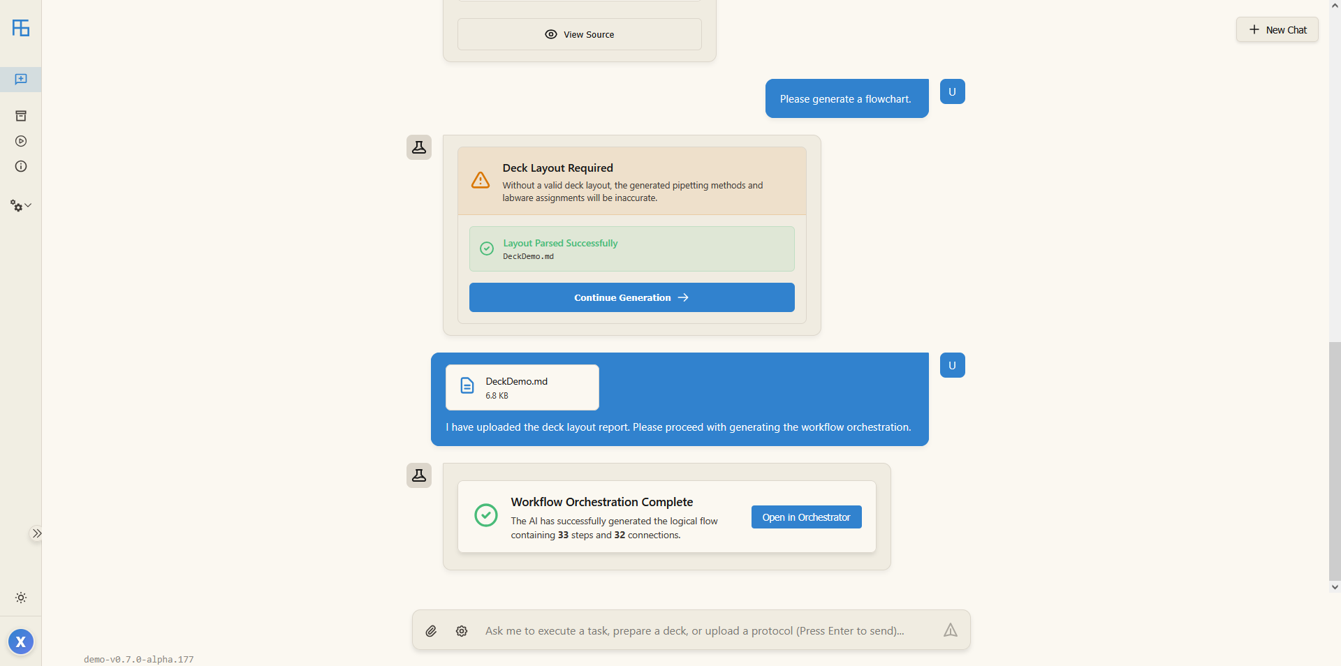

Unified Conversational Interface
The new version replaces the previous multi-page navigation with a unified AI chat interface. Simply type in natural language, and the system interprets your intent and surfaces the relevant features on demand. This shift from “searching for features” to “features coming to you” significantly reduces operational overhead and keeps your workflow focused and uninterrupted.

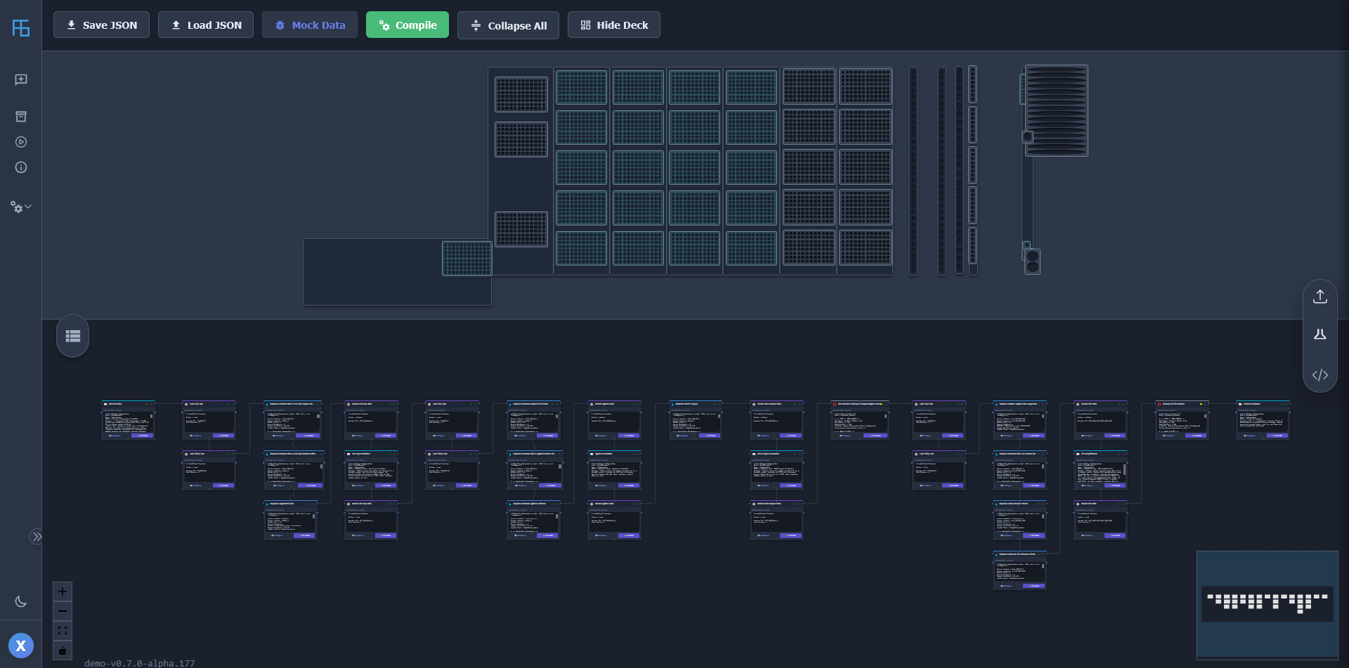

Protocol-to-Flowchart Conversion
You can now import an experimental Protocol and have it automatically parsed into a visual flowchart. Parameters can be reviewed and edited directly on each node. Once confirmed, the system compiles the flowchart structure and node data into a final executable method.

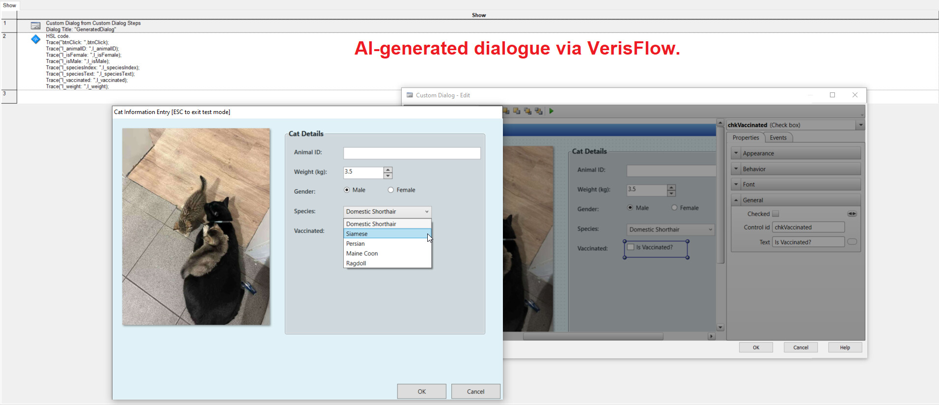

Hamilton Venus .med File Support
In addition to existing HSL (Hamilton Scripting Language) generation, this version introduces initial support for Hamilton Venus .med file generation — starting with Custom Dialog code. Full .med method file support is planned for upcoming releases.

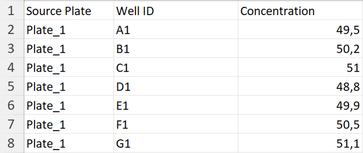

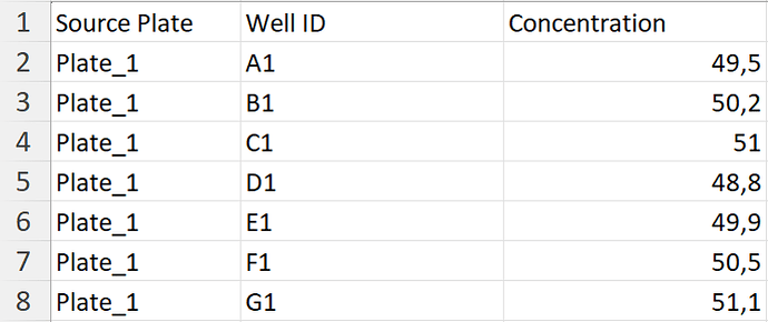

I began testing this capability by focusing on worklist handling. The goal is straightforward: upload a sample worklist, and the AI generates a complete .med method featuring a custom dialog for file selection. This generated method can then process any subsequent worklist that shares the same format.
I evaluated the AI software using three scenarios: a basic worklist, a serial dilution worklist, and a normalization worklist. The first two were used to optimize the AI software, making the normalization worklist a unseen test case.

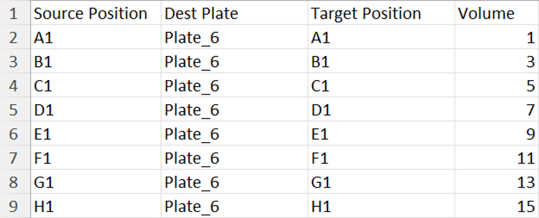

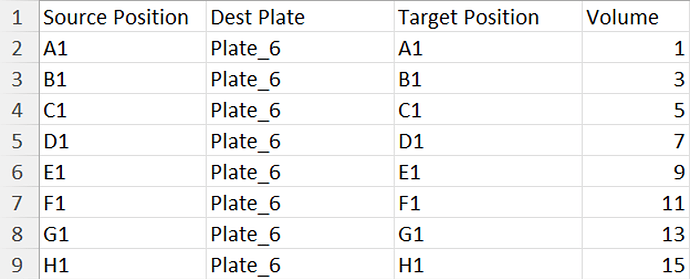

Below are the formats of these worklists, alongside the .med method generated specifically for the normalization task.

1. Basic Worklist: Volumes range from 1 to 1000 µL. The method successfully groups volumes and automatically assigns appropriate tips and liquid classes.
2. Serial Dilution Worklist: Based on the format discussed here: Help with worklist for serial dillutions

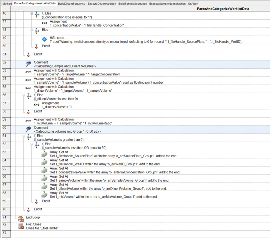

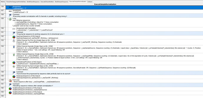

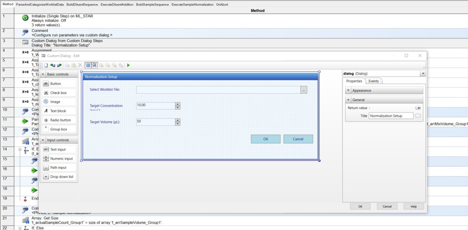

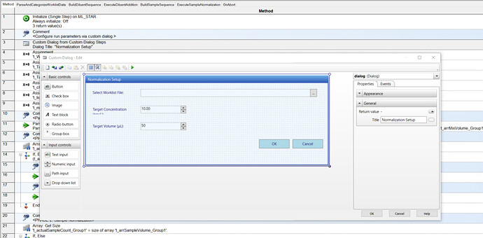

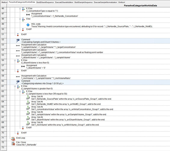

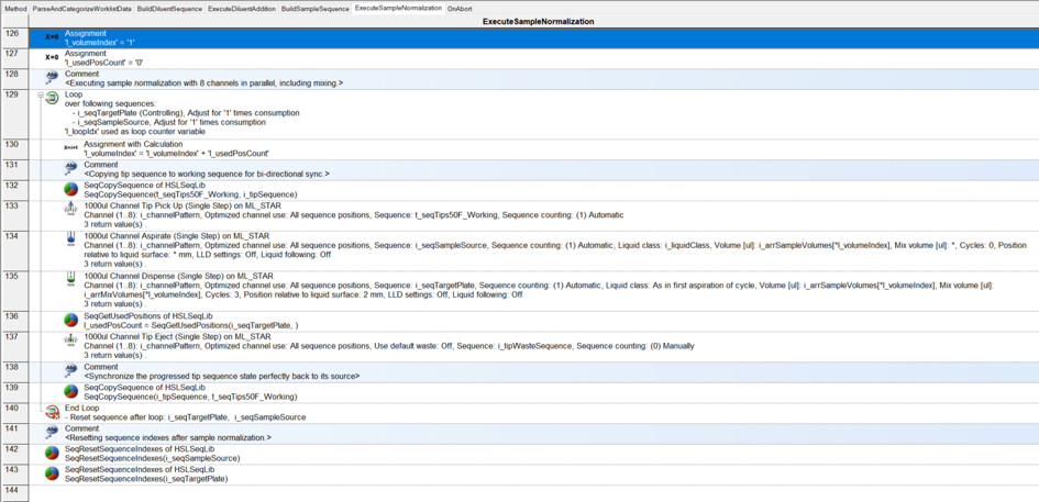

3. Normalization Worklist: The AI successfully generated a custom dialog featuring input textboxes for target concentration and target volume.
Below are parts of the .med method generated specifically for the normalization task. It was generated entirely by AI without a single manual correction, and it is functional.
Impressive work ! Do you mind explaining how it is able to generate .med files ? For hsl code I get it, but for the .med I don’t see how it can generate steps like aspirate/dispense/displacement.
@Yass
Thanks for the question! That is exactly the most complex part of the project. I began seeking a solution for generating Venus .med files when I started working on HSL generation last year.
Generating HSL is relatively straightforward since it is scripting text. The .med files, however, are essentially sequential and interlinked data structures that map to the visual steps (Aspirate, Dispense, tip handling, etc.) within the Venus GUI.
To tackle this challenge, I prepared my .med files as training samples, cleaned them, and extracted the underlying patterns. I spent a massive amount of effort manually mapping out the exact parameter settings and data structures required for these visual steps. This was an incredibly time-consuming process.
The architecture essentially splits the workload into two phases. First, the AI engine acts as a logical orchestrator—it translates the raw intent (e.g., from a worklist) into a sequence of intermediate, validated instruction data structures. Second, I built an independently developed, pattern-driven generator that takes this clean intermediate data and reconstructs it into the native .med data structures that Venus expects.
For instance, when generating an “Aspirate” step, the engine fills out a pre-mapped data template with data from a series of instructions, including parameters such as volume, liquid class, and others. This ensures the Venus software interprets it natively without throwing structural errors.
Ultimately, it is about extracting patterns from specific data structures, letting AI generate a schema according to intent, and then reconstructing the schema into those data structures.
