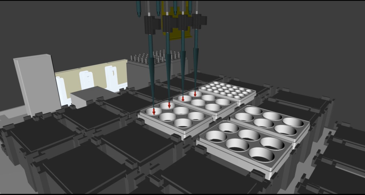

Does anybody by chance know if there’s a command to make the FCA channels spread out and dispense into multiple plates at the same time? I’d like to place multiple 6 well plates on the same segment. The FCA can physically spread its channels far enough do reach four plates simultaneously, but I can’t seem to find a way to make it do that. In a worklist it just goes labware by labware.

This might be a job for a custom super-labware. You may be able to create a custom segment with a single nest, and a single labware that fits on that nest that is in reality 6-plates spread across the entire segment.
Other than that, I’m blanking on how to trick your fluent into using sequence-style pipetting like Hamilton uses. It seems like there has to be a perfect coordination in the pipetting commands and labware to trick pathfinding into utilizing raster width for optimal pipetting across multiple plates.

I think I’ll just take the tuberack segment, and make a modified version where my wells correspond to tubes. Maybe that works. Or maybe it doesn’t. My team is happy with it doing 2 wells at the time which it does already, anything extra is bonus.

Apparently you can teach the first well and the last well outside of the dimensions of the plate. Atleast that’s how I understand his LinkedIn post.
Well that’s certainly one way to do it!
It works with two plates now, four plates are actually not possible because the FCA has a safety range for the spread that prevents it from reaching the full span that would technically be possible. I.e. if you spread it manually in Zero G it fits perfectly but the software refuses to spread the channels that much (it can however narrow the spread). 3 Plates and 6 channels simply wont align. At least for my machine.

Sorry been out in the field too much. Here is a link of the video. You have to customise the carrier to look like one plate and unfortunately deal with a slight mis-centred tip to well spacing. So only recommend this for large wells!

On a side note, I was able to center this very accurately for 6-well plates and omnitrays, by using channels 1,3,6 and 8. Since the distance between the first two wells and the last two wells is smaller than the distance between well 2 and 3, this works out very well.
