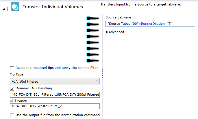

I have a script that uses Dynamic DiTi Handling in Sample Transfer, Transfer Individual Volumes, and Load Worklist Commands.
I’m having some trouble with the worklist command selecting the smallest tip size (50uL filtered). It is defaulting to 200uL filter tips even at 5uL in the worklist and will size up to 1000uL if needed, but it will not select the 50uL tips.
I copy pasted the Dynamic DiTi Handling setting from my Sample Transfer commands where the 50uL tips are appropriately selected. I’ve cycled through all possible “DiTi Types” selections above the Dynamic Line.

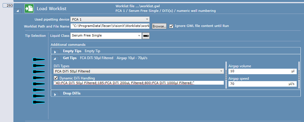

can you share a screenshot of the worklist command with DDH parameters??

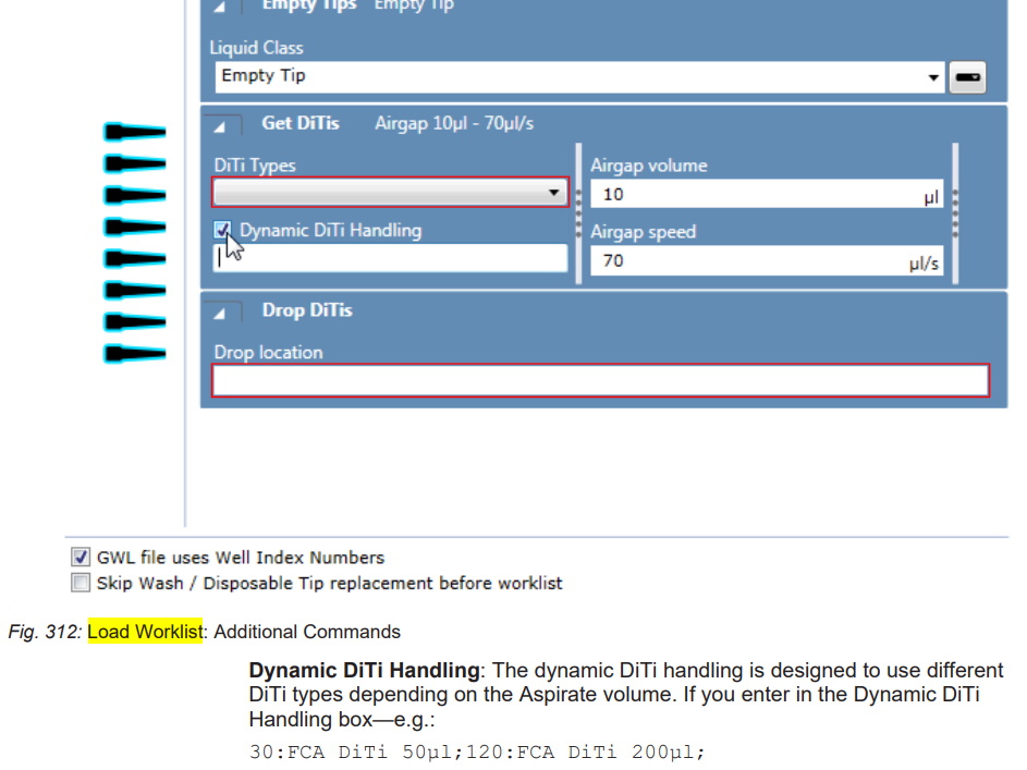

this matches the Help file

Turns out you need a leading semicolon (and maybe space) for the first item in a DDH command in Load Worklists. I have just brute forced every setting combo I could come up with. It should read:
“; 40:FCA DiTi 50uL Filtered; 185:FCA DiTI 200uL Filtered;”

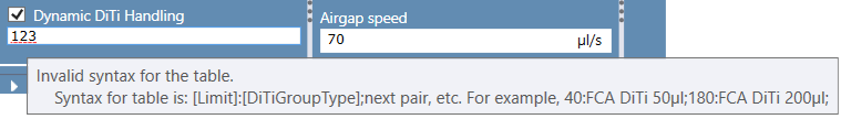

If you hover the mouse over the parameter while there is a syntax error it displays an example (there without double-quotes)

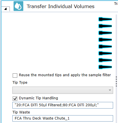

Other commands that have Dynamic DiTi Handling (Transfer Individual Volumes) contain an example in the text field by default (though there with double quotes), but one can copy it as an example syntax from there and adjust (& get the µ character this way)
