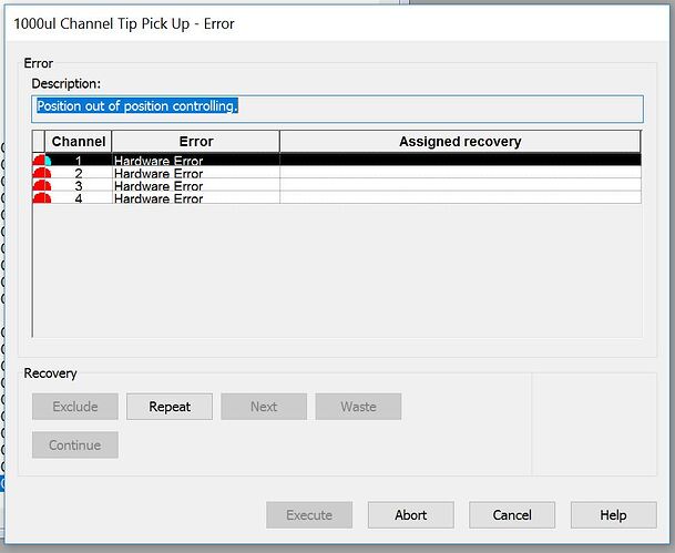

Has anyone encountered an error like the one below? This has occurred on multiple STAR instruments, so not sure if this is method related or something going on with the hardware. The gantry will move to pick up tips using the 1000ul channels when a loud crashing noise occurs then this error message pops up.

This error occurs when the expected position of the pipetting arm doesn’t match with the actual position of the arm. Based on the error and the crashing noise, this sounds to me like a hardware error and will likely require a service engineer to take a look at. That said, a couple items to consider:
  1. Are the STARs experiencing the error running the same method? If so, does the error occur at the same step in each method?
  2. Are firmware commands being used during any methods run on these instruments?
  3. Have you identified what exactly is causing the crashing noise?

    Yes, both STARs are running the same method and It happens at random spots of the method, however all occurring during 1000ul channel tip pickup commands. The gantry has made a sudden stop where this “crashing” noise occurs, however it does not always produce the “Position out of position controlling error”
